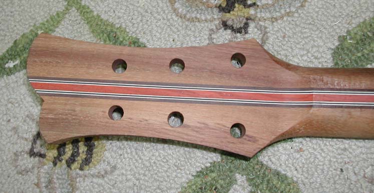

Here is the headstock of one I did a couple years back.

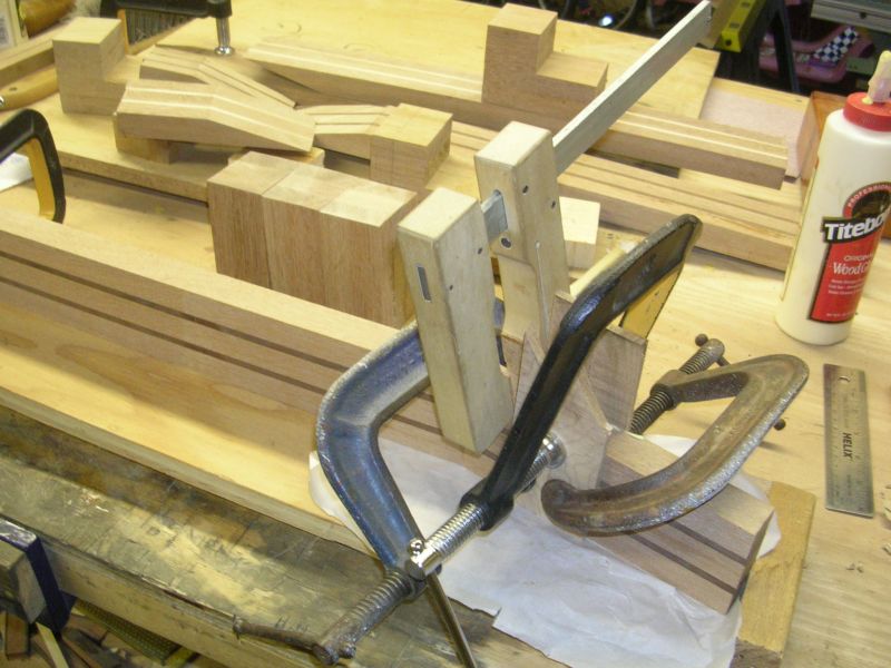

Here is a link to my neck glueup page. You can do the shop tour too if you like, Bruce

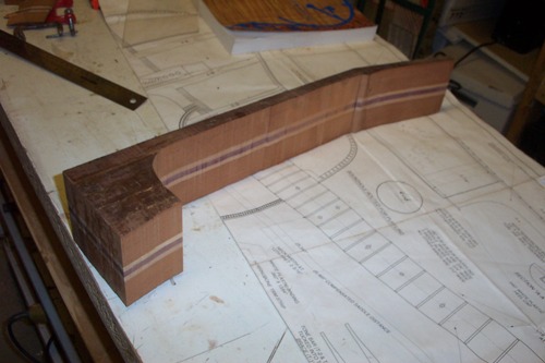

Here are a couple of pics of one of my necks, very similar to many laminated necks out there.

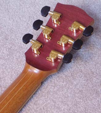

And here's another with a back veneer on it.

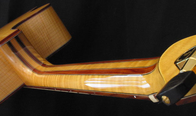

Just finished this one for father in-law. I think this pic maybe qualifies as neck art.

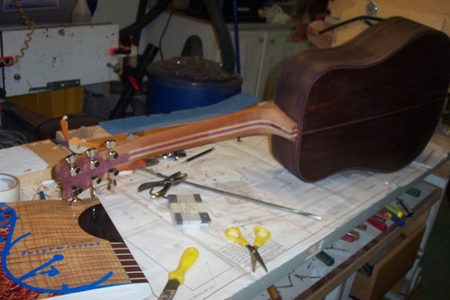

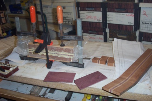

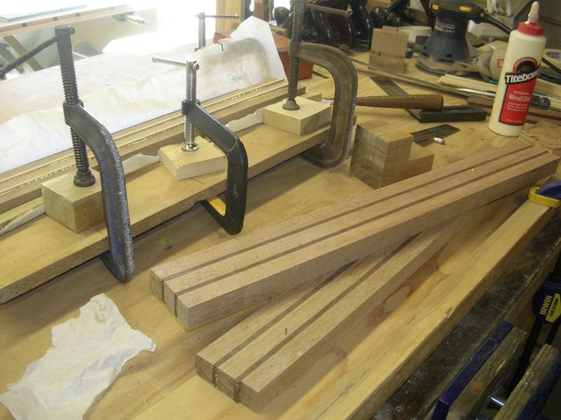

This is no 2's lamination with purple heart in the center, i glued the stacked heel with the same combo

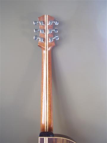

Here's the last steel string I did

Very nice guys! Mike, I always wondered how you guys installed the back veneer with a volute.?(mispelled?) I love this thread, some really nice laminations. Clinton

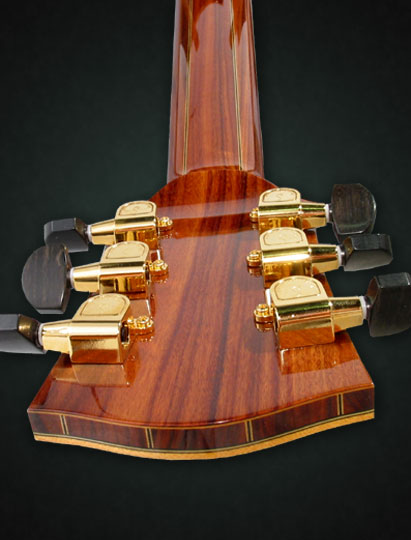

Here are a couple of my favorites. Man, I miss building guitars....

John, that last one belongs on a calendar or something!

Kevin, I really like that "neck art"!

I put the veneer on after the neck and volute are totally shaped/carved.
Make a clamping caul that's roughly the same shape as the back of your
headstock (including volute curve), and then put a piece of foam, or a
dense sponge, or something similar in between that caul and the veneer
when you clamp it on there. Helps to have a thin veneer too! After the
glue dries, trim the veneer to rough shape with scissors and sand flush.
PostPosted: Sun Dec 31, 2006 4:51 am
You can also vacuum bag the veneer on as well. You will still need to have it shaped properly, and tape it in place.

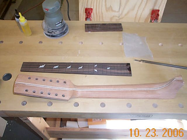

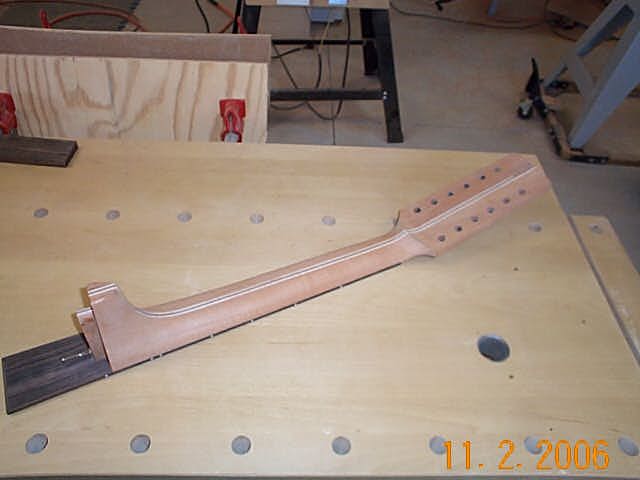

Here's a couple of pics of the 12 string I just shipped out.
And another...
